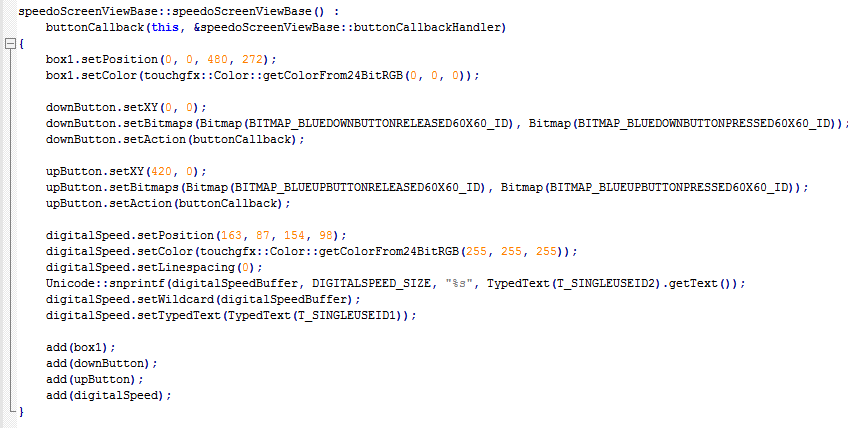

What is the "concrete view"? Any documentation for this would be very helpful. Do you mean the one that resides under the "generated" folder? This is where I find the items added from the TouchGFX Designer. Here are the items I added using the Designer.
Below is the constructor, which according to the comment at the top of the file, should not be modified. The items are added at the end of the speedoScreenViewBase constructor:
After I had done this work in the Designer, I manually added the needle shape as well as some other items. I did this in that screen's setupScreen function (in the file gui/src/speedoscreen_screen/speedoScreenView.cpp). I tried placing the call to the speedoScreenViewBase constructor before the "add" calls to these manual items as well as after, neither resulting in items in the Designer being visible.

By "Concrete" view i simply mean a concrete implementation of a baseview. e.g.
class MyView : public MyViewBaseThese will be placed inside the gui/ folder and not the generated/gui_generated folder. You should try to do your initialization in setupScreen() and not in the constructor. It can cause weird behavior (Maybe not in this case) since we use setupScreen() internally to initialize views.
I can't see your application. Can you try rearranging the elements to see if the order had an impact? From a designer perspective, your background / widgets that cover most space, should be at the bottom of the list.

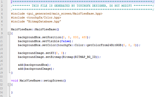

This was an experiment that I was conducting. I started a new project using the textureMapper and things seem to be working now, so I must have been doing something wrong in the previous example using Shape.
I agree that one should use the setupScreen function and not the constructor to do initialization. I was curious because the gui_generated base was doing initialization in the constructor.
Here is TouchGFX's "Animation TextureMapper Example" where the gui_generated file "mainViewBase.cpp". The initialization was placed in the constructor and not in setupScreen:
2019-06-12 2:04 PM
Yes, you're right and i've flagged this a while back. I hope we can get around to it soon :)
