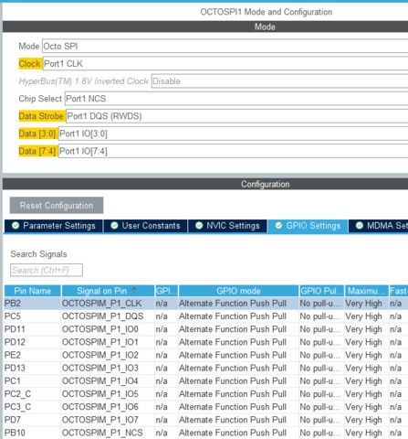

MCU: STM32H7B3IIT6
IDE: STM32CubeIDE Version: 1.8.0
GUI: TouchGFX Version: 4.18.1
SDRAM: IS45S16800F-7CTLA1-TR
FLASH: MX25LM51245GMI00 (OctoSPI)
I am using below pins
// STM32H7B3IIT6 PIN CHART
// MX25LM51245GMI00
// OCTOSPIM P1
// D0 PD11:AF9
// D1 PD12:AF9
// D2 PE2:AF9
// D3 PD13:AF9
// D4 PC1:AF10
// D5 PC2:AF11
// D6 PC3:AF11
// D7 PD7:AF10
// CLK PB2:AF9
// NCLK NOT USED
// NCS PB10:AF9
// DQS PC5:AF10I am using below configuration

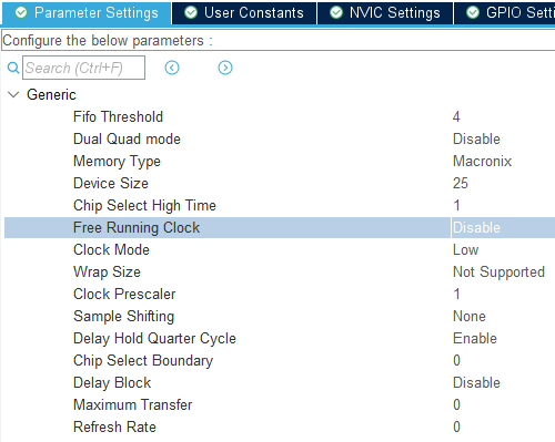

There is source for QSPI but dont have OctoSPI.

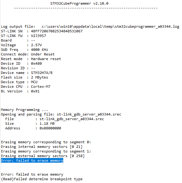

I created external loader for custom board. But it didnt work. I am getting below errror.
I shared external loader project file at attachment. Can you review it please? I need your support.
