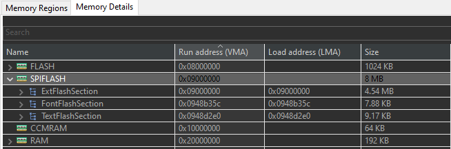

} >SPIFLASHafter compilation in CubeIde, the memory is created as shown below;

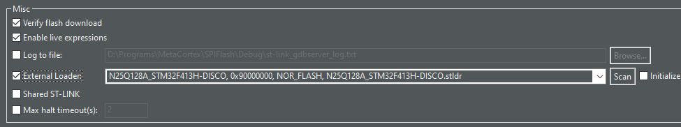

My problem is that I dont know how to download all those files to my board. As far as I know, I need to use external loader in debugger section but there is no convenient option in the tab which is exactly match with my configuration.
it will be appreciated if someone explain what to do additionally and explain all procedures step by step.

You'd have to write an external loader suitable for your part and board wiring choices. Not really a paint-by-numbers process.
If you've already coded something to initialize, erase, read and write the memory, you could integrate that into your application, allowing you to detect that the SPI isn't filled, and provide a method to download binary content via UART using say X-MODEM or Y-MODEM type protocol.

Do you have a data sheet for this "W95Q64" memory?
Do you currently have a viable driver, you will need something working/tested before proceeding to an external loader
This is attached to a SPI bus, it won't be mapped into the STM32's address space.
