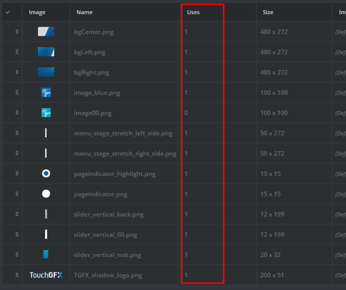

A lot of images are uploaded in to my TouchGFX project. I would like to removed unused images from there. How would I know if a particular image is used in the project or not? For example, Texts -> Typographies tab shows how many uses a particular font has. Similarly, is there a way to know if a particular image is used or not?

Hello BGuth.1,
Are you using the latest version of TouchGFX Designer (4.18.1) ?
Because the number of uses is clearly shown for images as well

Good to know the feature exists in v4.18.1.

I check this in 4.18.1 and counted is only images used in designer. I have many images used from code and show Uses zero.
2022-03-06 6:14 PM
Hello MM..1,
You are correct, and I'm glad you mentioned it since it could also be mentioned by other people ^^
The Designer does not read your user code so it is normal that the number of uses from code is not recognized by the Designer.
