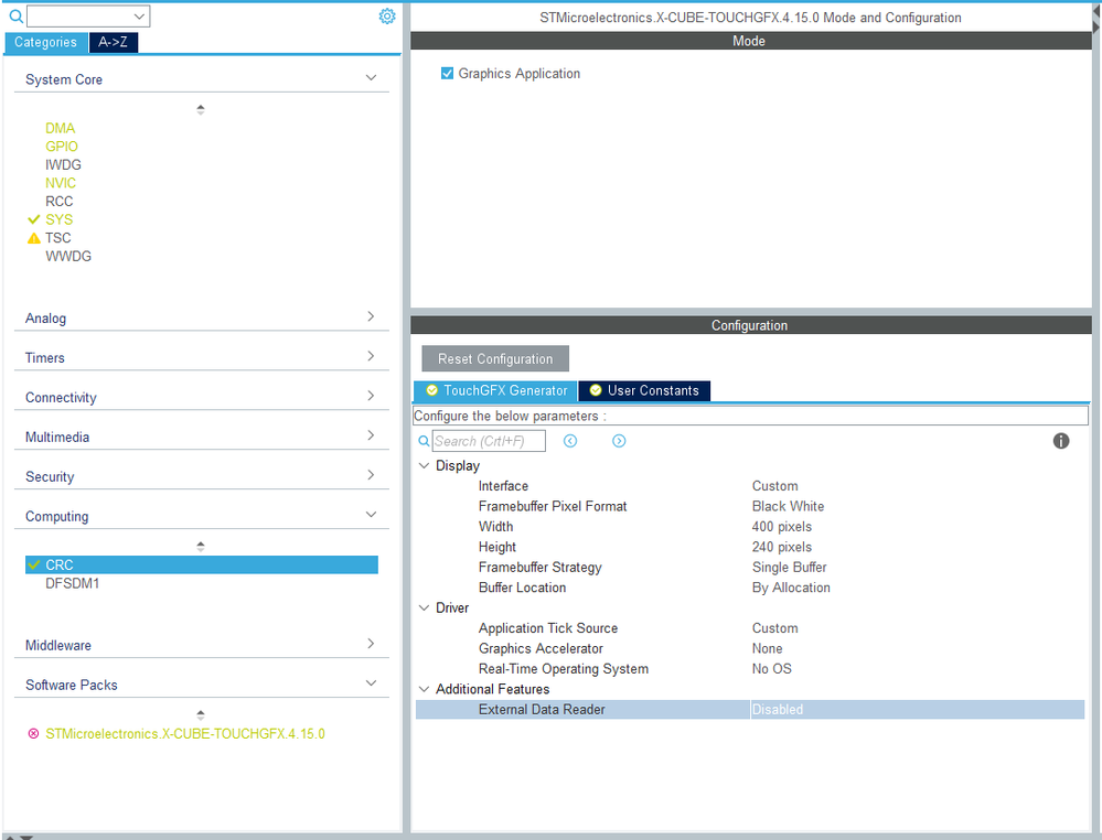

Update: from within CubeMX's Pinout Configuration, under Software Packs in the Categories-tab, I found that you also need to activate the TouchGFX-driver - which seems to become available AFTER the software pack has been enabled in the Software Pack Manager, and the application has been selected under Components Selector.
Seems a bit entangled way to do it, but now the TouchGFX folder gets generated in my CubeMX-folder. :thumbs_up:

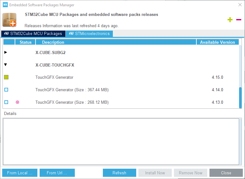

I'm using CubeMX 6.0.1. I have selected and installed the software package TouchGFX Generator 4.15.0 from Software Packages Manager:

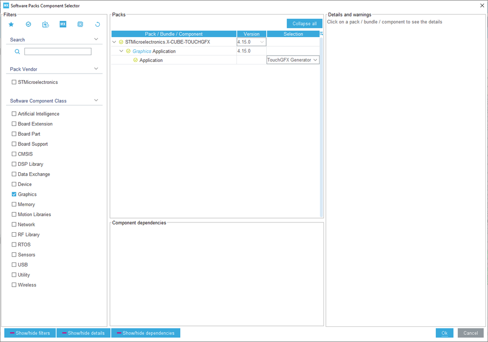

Furthermore I have selected TouchGFX Generator from the Component Selector:
