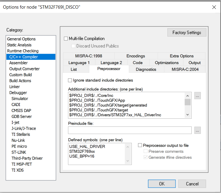

In both EWARM and uVision, I managed to add all the include directories so that the projects could at least find all the .hpp files to try and build.

Concerning the log output you're referring (Error[Li005]: no definition for "BitmapDatabase::getInstanceSize()" [referenced from ...) I guess what's missing is the path in the preprocessor configuration. But that shouldn't happen if you create your project the way I described.

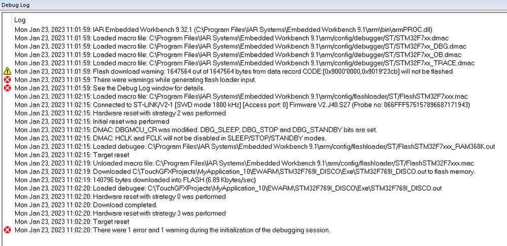

Looking at the debug log I get
Just in case you can't read the text, I get this:
Mon Jan 23, 2023 11:01:59: Flash download warning: 1647564 out of 1647564 bytes from data record CODE:[0x9000'0000,0x9019'23cb] will not be flashed

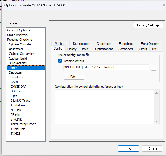

The settings for the linker is as follows
and I'll attached the file and stuck a .c on it in order to upload it.
I am happy to upload the whole project somewhere if that makes it easier or even have a remote session to debug this.
