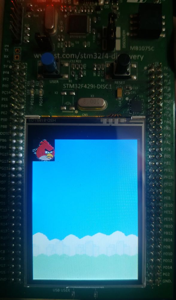

I am using STM32F429I-Discovery board I want to draw sprites on TFT-LCD with transparency on top of background image , I used black color as the transparent color for the images that I want to draw and used DMA2D at blending mode but the black color is not transparent and the sprite was drawn with a black color surrounding it.
the sprite color mode is RGB565 (I have tried ARGB888 also with no hope) .
