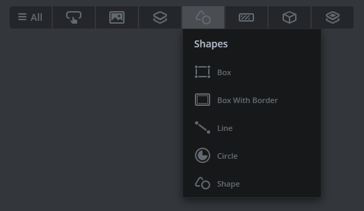

Place one of each on screen in designer and read generated screen code.
2021-12-13 5:54 AM
There is no exact one-to-one mapping in the TouchGFX framework since it is a object-based or scene rendering approach (see Graphics Engine | TouchGFX Documentation).
If you aim at converting an STemWin GUI into a TouchGFX one you must first detail you UI in terms of visual objects (i.e. line, bitmap, box/rectangle) and then setup you screen adding each of these elements, using the corresponding widgets :
Then the TouchGFX library rendering engine will take care of updating their appearance on display depending on the GUI logic so GUI_DrawLine will internally mean to redraw the line widget.
