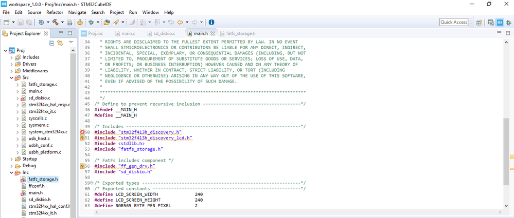

2019-07-05 2:13 AM
you see Michael, I have some errors in #include, I didn't find the #include "stm32f413h_discovery.h"
2019-07-05 2:39 AM
Check if the file is present on the disk, if so you may have an issue linked with a "too long path" for "path", this is typical in Eclipse...
Then you need to copy the project to a folder near your hard drive root, e.g. C:\Temp.
But be carefull, you will need to copy the example folder as well as as other folders that are common to all F4 boards (drivers, middleware).
To do it quickly, just copy the entire Cube Firmware to C:\Temp, so you can verify that the build is fine.
In principle the dependencies are reference with relative paths (include, lib).
Then you will remove useless folders.
In principle you should keep the following folder structure (and even then you should be able to remove some) :
C:\Temp\Drivers\BSP\Components
C:\Temp\Drivers\BSP\STM32F413H-Discovery
C:\Temp\Drivers\CMSIS
C:\Temp\Drivers\STM32F4xx_HAL_Driver
C:\Temp\Middleware
C:\Temp\Projects\STM32F413H-Discovery\Applications\Display\LCD_PicturesFromSDCard
Best regards,
