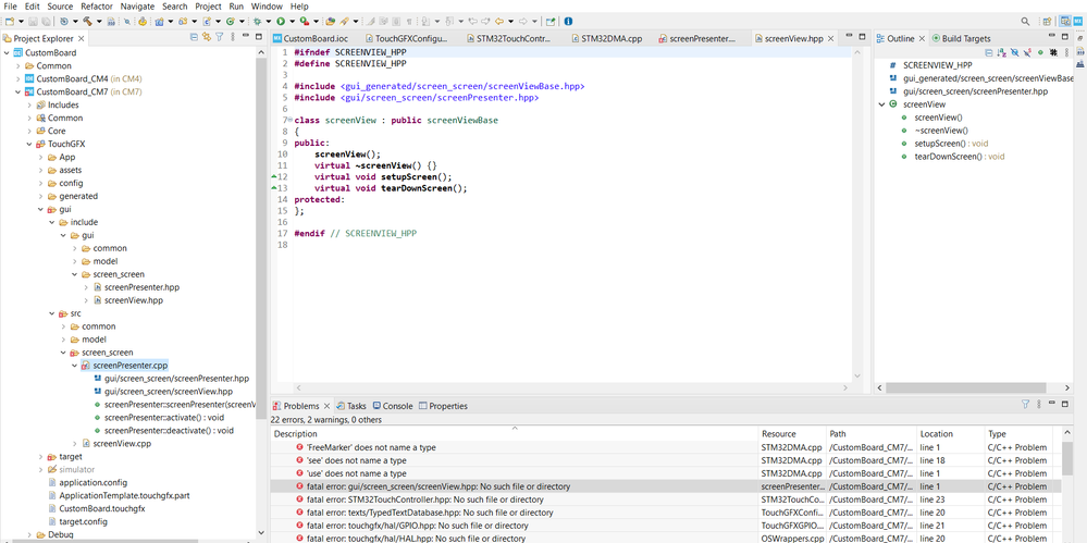

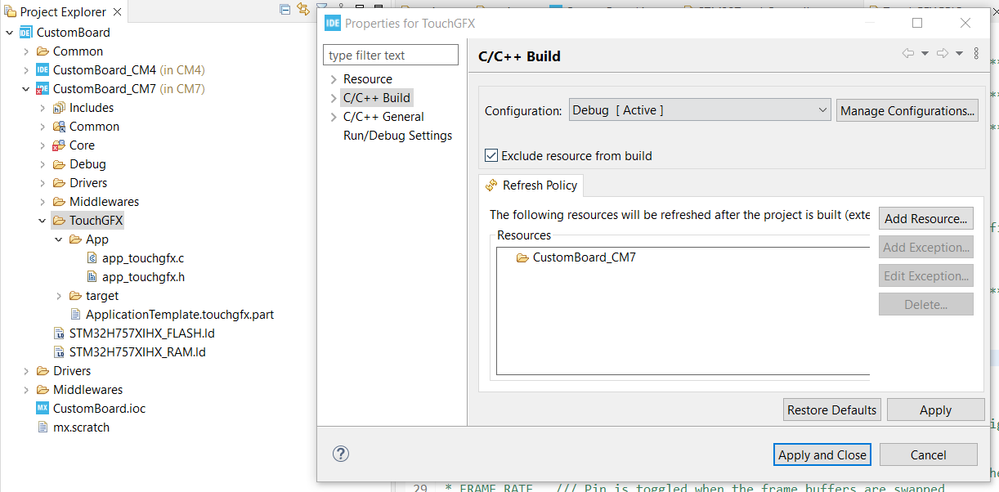

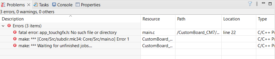

Hello Everybody, I am trying to create a TouchGFX project for my custom board. I follow embryonic.dk's video on Youtube. However I couldn't manage to build a project. I received errors in the first image. It says No such file or directory for app_touchgfx.h. However, It is in the project. The interesting thing is when I check it's properties the exclude resource from build option was selected.I deselect it. But I receive more errors. I tried to deselect exclude from build option for every folder in the project manually but it didn't work. How can I create a TouchGFX project for my custom board? I was not expecting that it's gonna be that hard. I don't have much knowledge. I am using STMCubeIDE version 1.10.1, TouchGFX generator version 4.20 and TouchGFX Designer version 4.20.

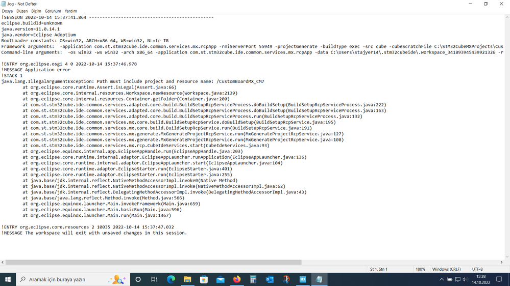

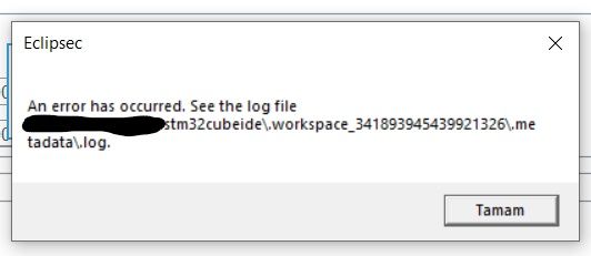

Hello @Osman SOYKURT ,
I tried to use STM32CubeMX but unfortunately I got an error. When I open the .log file, It says !MESSAGE Application error
!STACK 1
java.lang.IllegalArgumentException.

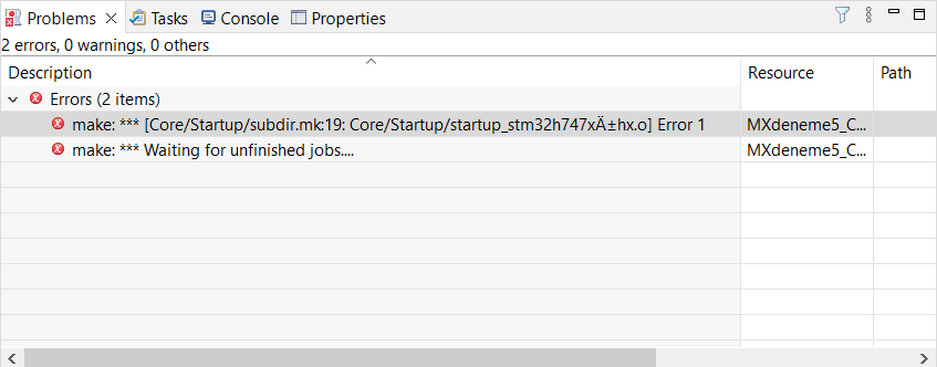

I didn't try to open my .project file in STM32CubeMX. I followed the instructions in the video. When I try to build the project, I got this error. When I check the Startup file, its name is startup_stm32h747xıhx.s . I guess that ı character might be the problem. I tried with some other MCUs with I character in their part name and got the same error. I also tried with STM23H750XBH6 because there is no I character in its part name. STM32CubeIDE builded the code successfully without error. I thought about changing the startup file's name but I don't know if it is safe. I don't want to break something. What are your suggestions?

2022-10-28 9:39 AM
I changed the startup file's name and it seems it worked. But that was an attempt without TouchGFX. Here is the latest situation:
If I try to start with STM32CubeMX, it throws that error with .log file. When I do not use TouchGFX generator, I don't face with this error. Also I tried to use TouchGFX Generator with STM32H750XB6 selected and it works. If I choose a MCU with I in its part name, it throws that .log error. I changed my computers language but it didn't solve the problem. I also tried on my colleague's laptop which is in English but nothing changed.
If I try to start with STM32CubeIDE, it throws "there is no such a file or directory" error for cmsis.h, freertos.h and also sometimes for app_touchgfx.h.

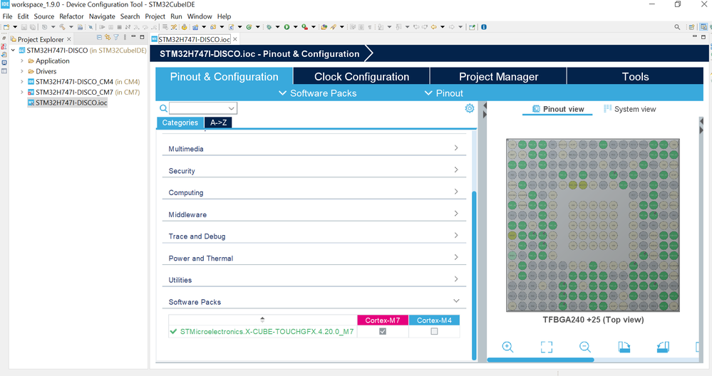

2022-10-31 1:12 AM
Okay, the problem is not part name, it is the dual core. When I choose a single core MCU, everything is ok. But if it is dual core, then I have issues.
