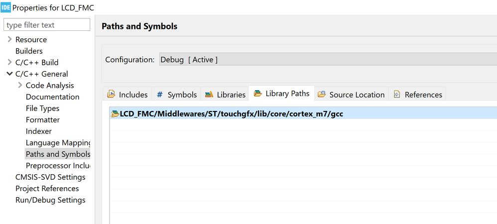

2020-09-06 12:52 PM
2020-09-07 11:34 PM
How can I solve the error?
2020-09-08 1:13 AM
I'm investigating and will give you an answer as soon as I find out the problem.
/Alexandre
2020-09-08 1:51 AM
Thank you so much Alex.
2020-09-08 2:40 AM
You library path was incorrect, you need to change it. I suppose you modified your project name and therefore the lib path was lost.
Also, after this I still had issues because you don't have enough internal RAM for an entire framebuffer.
If you look at the .ld file in STM32F746ZGTX_FLASH.ld
You only have this written :
MEMORY
RAM (xrw) : ORIGIN = 0x20000000, LENGTH = 320K
FLASH (rx) : ORIGIN = 0x8000000, LENGTH = 1024K
}However, to store a framebuffer 800x480 with 16 bpp you need 480x800x2/1024 = 750KBytes > 320 KBytes
You need to add external RAM otherwise you cannot do much.
/Alexandre
