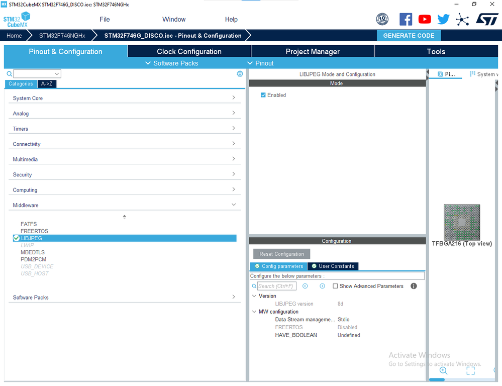

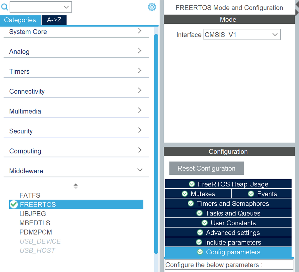

In MX wizard untick RTOS in touchgfx and addware config , delete manualy target folder in Touchgfx , after this close MX and generate bare metal code. Or create new project .
Switching methods in existed project dont work ok.
2022-07-31 9:50 PM
Thank you for the reply. Can you explain what do you mean by addware config.

Too need disable and clean refresh project after generate. Plus better is show error as share ...
2022-08-02 2:45 AM
Hi...

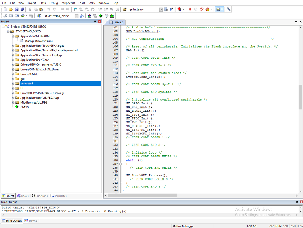

I have disabled Free RTOS and regenerated the code. But It got hanged at hard fault handler.
