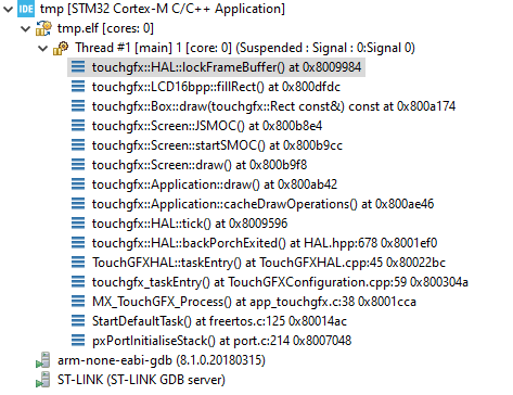

2020-08-27 5:33 AM
this code stoped in point -> No source available for "touchgfx::HAL::lockFrameBuffer() at 0x8009984"
function lockFrameBuffer() realised in static library touchgfx or need redefine this?
2020-08-27 6:07 AM
lockFrameBuffer() is a function from the lib. It does not need to be redefined.
lockFrameBuffer() calls OSWrappers::takeFrameBufferSemaphore();
So please check your OSWrappers.cpp file and monitor the state of your semaphores.
/Alexandre
2020-08-27 10:04 AM
If i give semaphore with some period ( OSWrappers::giveFrameBufferSemaphore(); or OSWrappers::giveFrameBufferSemaphoreFromISR(); ). The program remains in the lockFrameBuffer();
If i am redefine lockFrameBuffer(); in TouchGFXHAL module as:
uint16_t* TouchGFXHAL::lockFrameBuffer(void)
return getTFTFrameBuffer();
}Then program escape from lockFrameBuffer. Where is the configuration error? I can share my project over github.

2020-09-09 12:14 AM
I fixed this issue. I configured my project with "custom" graphic accelerator. But I changed configuration to DMA2D and my project successfully work.
Best Regards!
