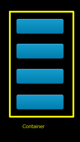

I placed the buttons which are made with custom container in ScrollList.
I'd like to change screen by pressing each button.
How should I write my code for pressing button and change screen?
