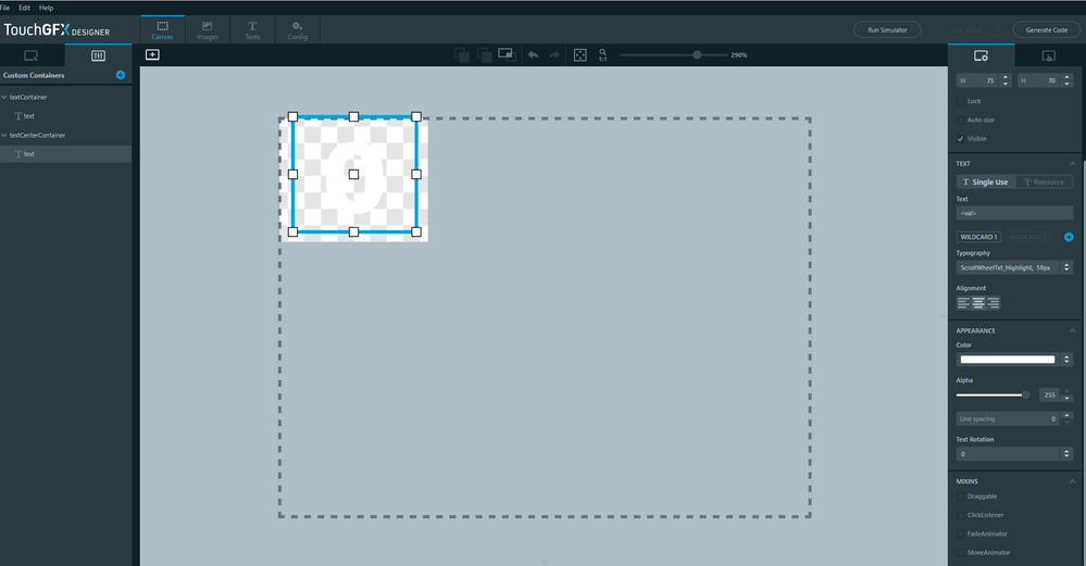

I try to make a custom wheel for my project. In the TouchGFX designer, I can set the "Number of Items" but cannot configure which items (in my case numbers) are going to be displayed.

Thank you for your very fast reply. I created a custom container and in the "Text-line", I used a wildcard instead one text or multiple complicated structure, as you suggested.
I already used this custom contaier as a Item template in scrollwheel widgest as you suggested.
The issue is more, that I cannot/don't know how to initialize these values in the STM32CubeIDE.
