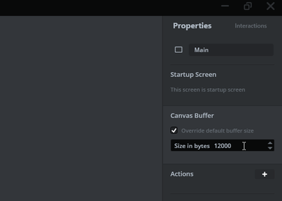

At the top right of TouchGFX Designer, you can increase the Canvas Buffer:
This is used for lines, boxes, SVG images etc but not for all the widgets.

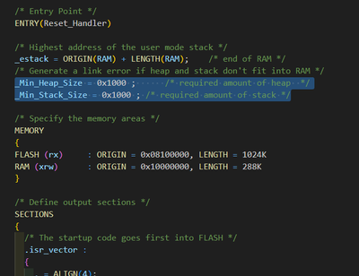

Another solution would be to increase the TouchGFX heap in the linker script (in the "gcc" folder, the file with the LD extension):
You can increase the minimum heap and stack from there.

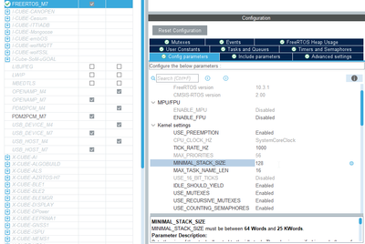

A final solution is to increase the FreeRTOS stack size (if you use FreeRTOS) in the .ioc file :
