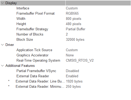

I want to make a graphics application on my Mikromedia 7 Capacitive board with the STM32f746ZG MCU (320kbytes SRAM and 1MB Flash Memory) and an external SPI Flash SST26VF064B. Besides, I use partial framebuffer strategy.

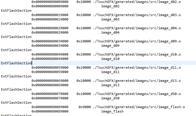

I managed to store my images in the Flash with a loader and now I'd like to display them on my screen. I've got interested in the external data loader like this :
I followed this page : https://support.touchgfx.com/docs/development/scenarios/using-serial-flash#images
It generates TouchGFXGeneratedDataReader and TouchGFXDataReader files. I Implemented the functions, but the program just goes through AdressIsAddressable() and nevers gets into CopyData or startFlashLineRead functions.

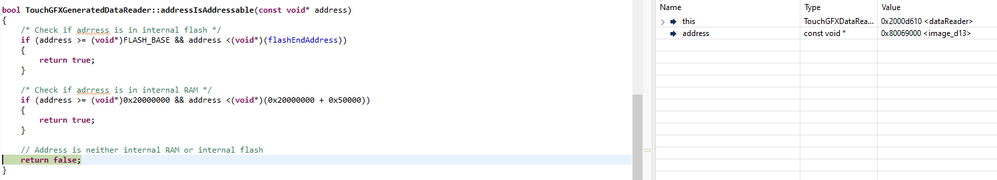

Yes it is, for example, I made a simple application with just image_d13 on my screen, here is how it is stored :And then, this is how the program recognizes my image in the memory at address 0x8006900.

AddressIsAddressable
https://support.touchgfx.com/docs/api/classes/classtouchgfx_1_1_flash_data_reader
Your implementation seems consistent with expectations. I suspect you'll need to step into the code, or walk a disassembly listing (objcopy, fromelf, etc) to understand why it subsequently doesn't call your reader functions. I might suggest instrumenting that code so the decisions and calls can be monitored via a serial terminal real-time to confirm flow/dynamic behaviour.
