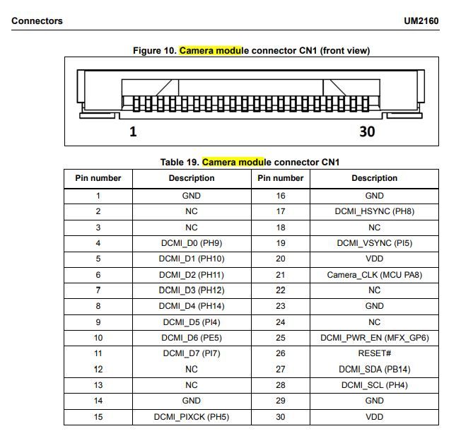

You can use OV2640 CMOS sensor with L4 board, but make sure that your camera module embedded the OV2640 is compatible with the camera connector CN1 of 32L496GDISCOVERY.
I advise you to refer to the Table 19. Camera module connector CN1, in the UM2160 and check the pins and configuration.

Thanks for your resoonse, I read the datasheet but I bought a OV2640 with FFC conector but it turns out that it has 24 pins and the conector of the STM32L496G_DISCOVERY has 30, so can you recomend me other mudule or a solution for that.

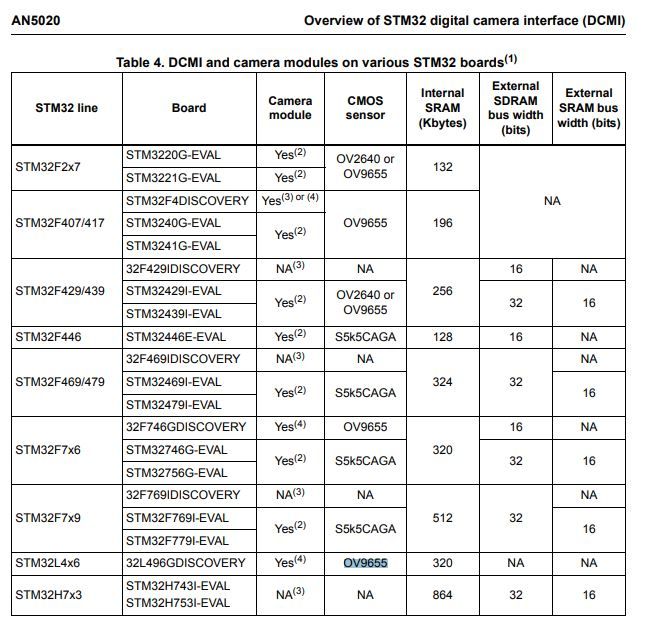

You can use the OV9655 CMOS sensor with the STM32F4DISCAM camera module.
I advise you to refer to the table 4 (and note 4) on the AN5020 - page 21.
