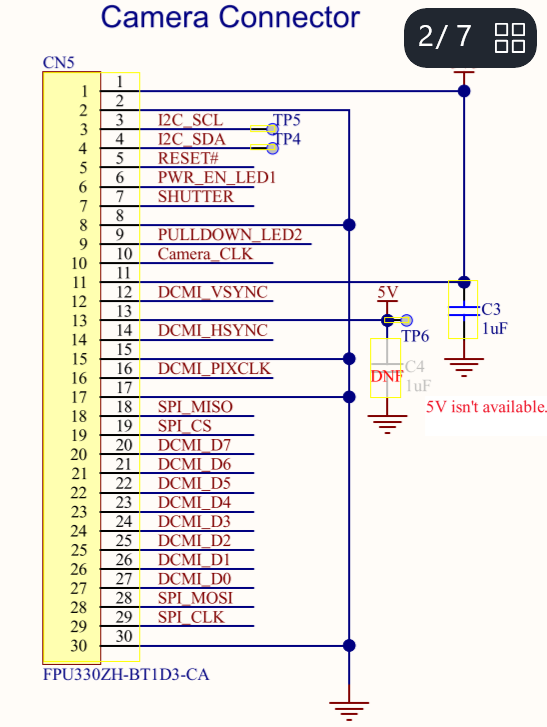

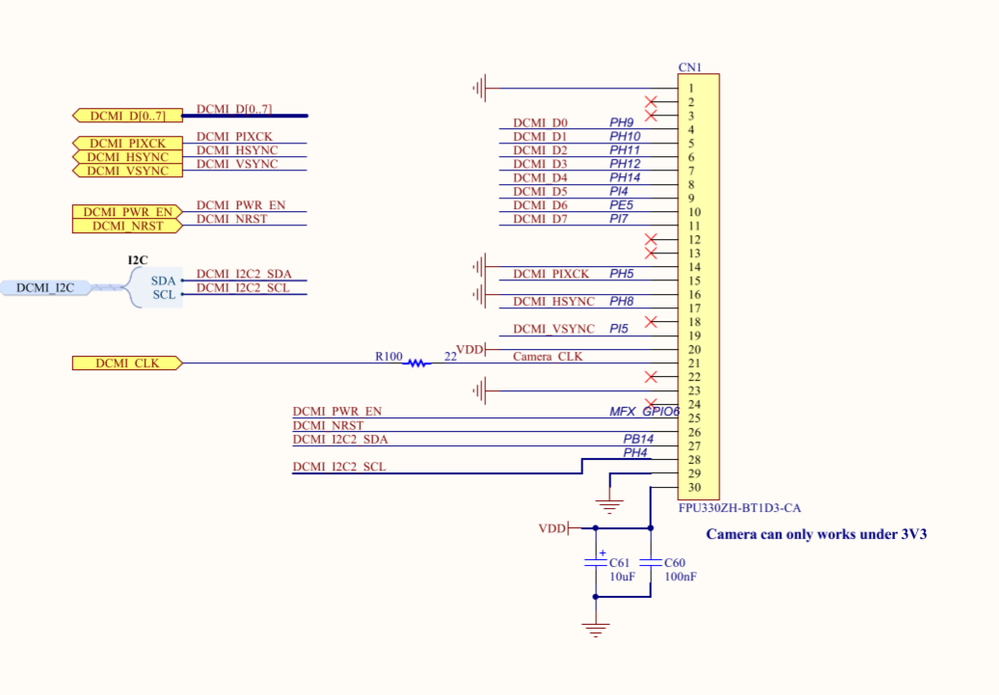

Thank you for answering my question, in the datasheet i see that the configuration of the pins of the module y 32L496GDISCONVERY is diferent.
the first picture is the zif conector of the camera module and the secund is the zif conector of 32L496GDISCOVERY.

Well spotted, but your observation also applies to the 32L4R9IDISCOVERY, whose pin assignment of the camera connector is identical to the 32L496GDISCONVERY.
If you look closely, you will notice that the pins are crossed: 1-30, 2-29, 3-28 etc. This is because the connectors are horizontally rotated by 180° on the boards and the ribbon cable realises exactly this crossing.
Clear now?
If the problem is resolved, please mark this topic as answered by selecting Select as best. This will help other users find that answer faster.
/Peter

Hi @Peter BENSCH
Thank you so much for your help, you're right the pins are crossed.
