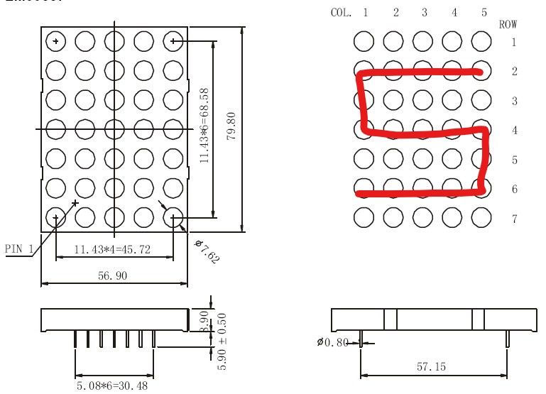

I need to skip the upper row and lower row and print the characters.

2021-12-15 6:08 AM
Show us what do you have so far - both hardware and software.
What do you mean by "skip the upper row and lower row"?

Hi waclawek and andrew please see attached pdf and actual i need to print as picture show im following as per pdf but udc(user defined code) address start with 80 upto 8f in 1st address i can store remaining is not working. im communicating display with parallel bus using stm32 controller.
2021-12-17 3:51 AM
Thank you for suggestions @Andrew Neil and @Community member. I got the issue it was some address problem I Solved it.
