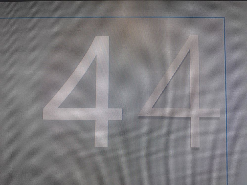

2021-05-21 1:15 AM
Hi Michael, A mistake on my part, I was looking at the wrong font, so I still have a problem with the font: AzoSans-Light.ttf. I've attached a .jpg of the digit '4' from TouchGFX designer. The one on the left hand side is distorted, it should have straight lines similar to the one on the right hand side. If I use AzoSans-Light.ttf in a Word document the digit '4' does not distort.
Thanks, Will.
2021-06-02 7:43 AM
Hi Michael, any thoughts on why I'm seeing the digit '4' distort like this using the AzoSands-Light.ttf font?
Thanks, Will.
