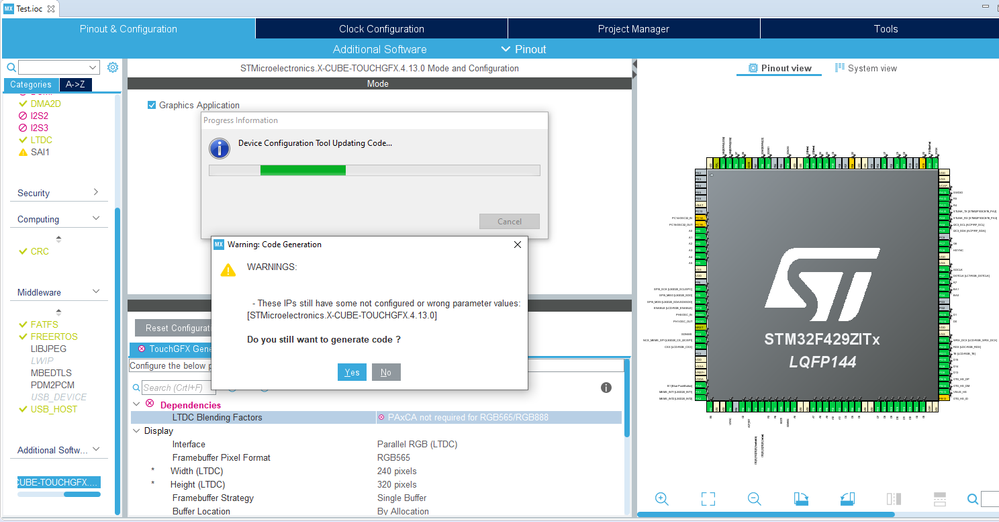

Now i`m using cubeide with touch gfx, and i have a problems with cubeide becouse i can`t generate the graphic project like everybody do it on tutotrials on yt. they have a little bit different board (with bigger screen) but i`m doing everything exactly like they and i have message like in the picture. Somebody know the reason??

ST has BSP to help you with that.
If you simply use the STM32F429-DISCO application template from the designer this is set up for you
/Martin
