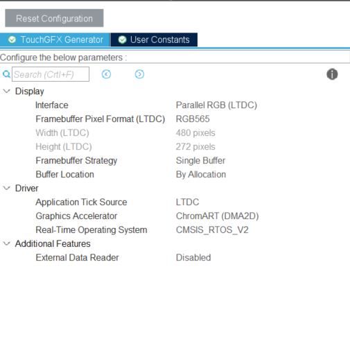

2) I change the setting from gfxStudio to load assets (image and text) from internal FLASH. How I can access to the external resources?
in other words, I configured also QUADSPI(2) but "external Data Reader" is always not settable.

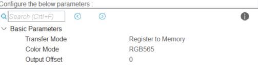

1) FREERTOS = I changed some "Config parameters" copying H7B3DKsettings -> DONE
2) FREERTOS = i changed Heap size, I replaced the StartDefaultTask with TouchGFX_Task and increased stack size to 4096 -> -> DONE
3) I checked if TouchGFX_Task function wasn't present MX_TouchGFX_Process(); -> -> DONE

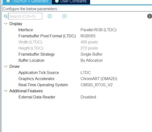

4) on SOFTWARE PACKs--> TOUCHGFX 4.15 = I changed Buffer Location setting to "By Allocation" -> -> DONE

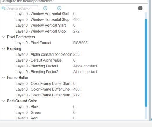

5) on LTDC --> Layer Settings = I changed Layer 0 - Color Frame Buffer Start Address to ZERO -> -> DONE

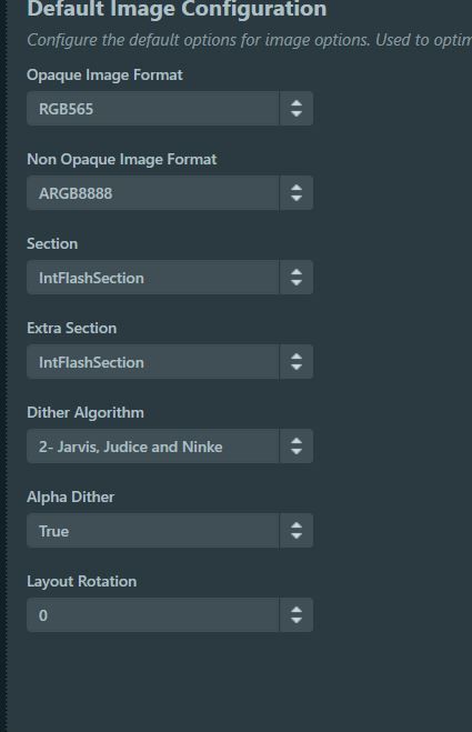

In TouchGFX Designer i changed to Internal Flash
