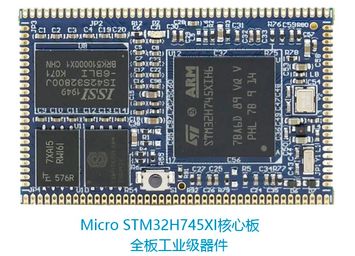

I have been working with this waveshare's H743 board in past.
Presently I'm working on STM32H745 SOM and Samsung Tab3 10.1" 1280X800 TFT. Its a custom designed board.
