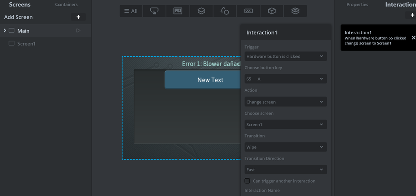

2025-01-08 11:01 AM - edited 2025-01-08 11:03 AM
Ohh boy zero info... Try this
run simultor and press A key on keyboard Work transition ?
Interaction1 in my example is add on main screen (FYI your screen marked to start) and transition go to Screen1...
When this works ok you can step to physical button code ...

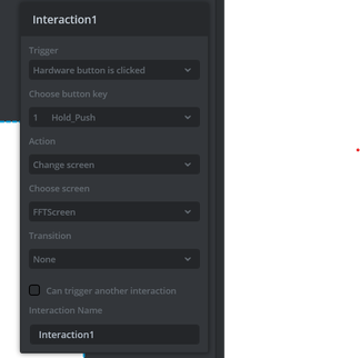

2025-01-09 1:26 AM
Hi thanks for the reply,
I have tried setting the hardware button up in this way and the screen changes as expected in the simulator.
I also know the hardware button is working as I have another button used for saving images to a USB that works correctly.
However, if you have any suggestions on how to call the change screen functions through code even without pressing a button that would be great too (for example calling it after a short delay in the main while loop).
Josh

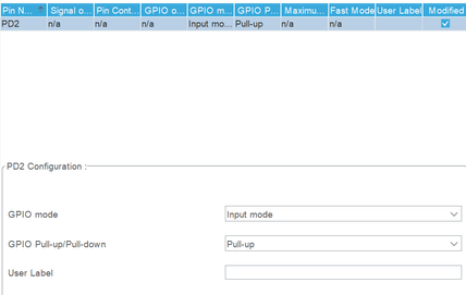

}And here is how the button is configured in the ioc file:
Thanks again,
Josh
2025-01-09 1:50 AM
Hi, thanks for the response.
I have checked my StartUpScreenViewBAse.cpp file and it appears to have generated correctly.
void StartUpScreenViewBase::handleKeyEvent(uint8_t key)
if(1 == key)
//Interaction1
//When hardware button 1 clicked change screen to FFTScreen
//Go to FFTScreen with no screen transition
application().gotoFFTScreenScreenNoTransition();
}Is it that I need to call "application().gotoFFTScreenScreenNoTransition();" from another place in my code?

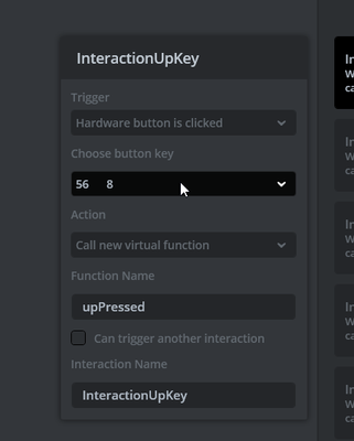

2025-01-09 4:11 AM
Hello @Josh_W020 ,
From what I understood, you are sure that the button itself works and you are sure that you are able to do a screen transition.
So the issue must be between connecting these 2 actions.

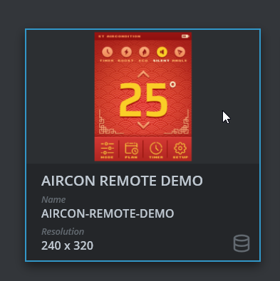

We provide examples of boards and UI using hardware buttons with the GFX01M2 display extension.
One of the GUI using hardware button is the "Aircon remote demo":
Instead of adding a hardware button to TouchGFX Designer (which is possible), we mapped it to a keyboard key.
This way, we can execute an interaction from pressing a key on the keyboard (when simulating for instance) and we are also able to map our physical button to execute the interaction.
Here you can see that the interaction is executed when pressing the key '8' :

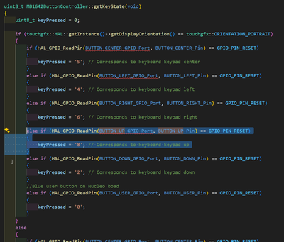

And here you can see how we mapped the hardware button to a key in MB1642ButtonController.cpp :
I hope this example is helpful to you!

2025-01-09 6:51 AM
I manage it in model tick, TGFX examples with key is long way ...
Try in model.cpp
void Model::tick() {
if (HAL_GPIO your button test == SET) {
//wait for release add here
static_cast<FrontendApplication*>(Application::getInstance())->handleKeyEvent(
'A'); // here use key from my window example
...good is add inteligent key handler release this is only example. Positive is this send event A key to actual screen , and this can handle different reactions on different screens. All is setup in designer.
And your second Q transition with delay you can setup in designer. Not require any code in main or while.
Learn use Interactions, here for example exist action wait for ...
