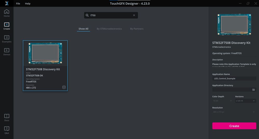

For instance, to control the LED on the board, first I create a project in TouchGFX.TouchGFX Project

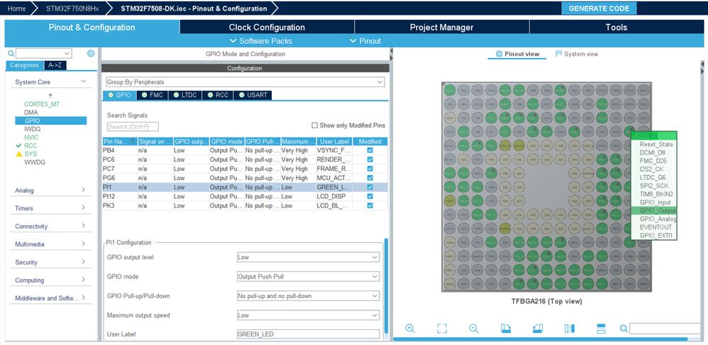

Then, I open the STM32CubeMX project (.ioc file) created by TouchGFX, and by using the schematics of the board available at here , I set the pin for the Green LED (PI1) as output, so I can turn it on or off. And then, I press Generate Code.CubeMX GPIO settings

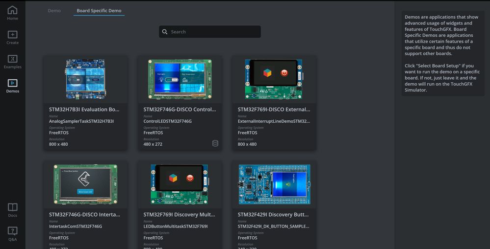

You can read more about the connection of TouchGFX application with the hardware here , and you can see more examples in the Demos section of TouchGFX in the Board Specific Demo tab.Board Specific Demos
