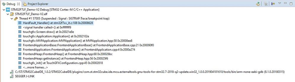

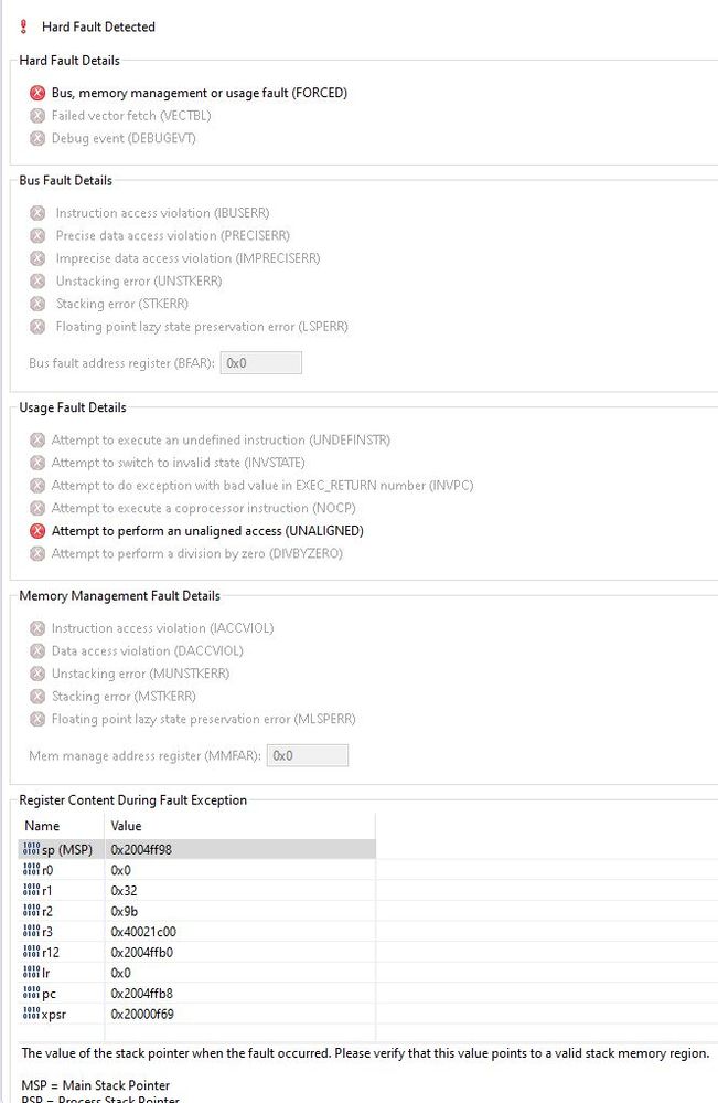

But the TouchGFX application fails immediately at startup whith a hardfault within the MX_TouchGFX_Init() function. The debugger is of not much help here, because the fault happens in a pre-compiled part of the TouchGFX library:
Any hints or ideas where to look for a solution of this are more than welcome.

MX_TouchGFX_Init() gets called in main before osKernelStart(). So there is no task scheduling and therefore no task stack at that time. I tried to call MX_TouchGFX_Init() in my default task, too. But that does not change anything. And debugger tells me there is no stack over/underflow.
My main problem is, that I do not have source code of the failing function call touchgfx::Screen::draw(). So I cannot see which access causes the fault in detail.
I guess I missed some initialization, or there is an issure with peripherals being initialized and running by the boot-loader already?
