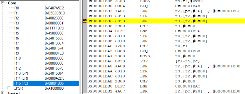

2019-12-03 2:01 PM
Try to single-step in disasm to find the exact operation which leads to the hardfault.
2019-12-04 3:28 AM
In attached screenshot, you can see the exact operation and the corresponding registers. This is in Function CRC_Lock
Maybe you can help me identifying the problem, because I have no idea what could be wrong here.

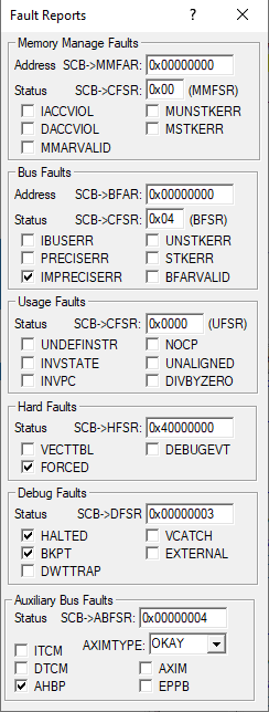

And here the Fault Reports:
One other "funny thing": After flashing the software (without debugging) the application does not start after pressing the reset button on the DK. Only a power off / power on cycle dose help.
