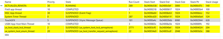

2024-02-15 2:40 AM
Hello, new tests
I have managed to make it work using HAL_SPI_recive_IT and HAL_SPI_recive_DMA.
But I can't get it to work HAL_SPI_recive.
The solution has been the priority of the interrupts. Configuring them as follows:
I would like to know if this saturation is normal or if I am configuring something wrong?
2024-02-15 7:35 AM
"normal" depends on what all you've got going on with the other interrupts and DMA operations. The two OCTOSPI ports, LTDC and USB HS ports are all potentially high bandwidth interfaces. I have no experience with OCTOSPI or LTDC, so I don't know what kind of load they (or their HAL drivers) put on the CPU. FLASH and external memory wait states also impact CPU throughput, as does all the arbitration between all the different peripherals and the memory bus.
But in general, any time you are trying to handle incoming or outgoing data at a "high" data rate, DMA should be your first choice as it minimizes the number of CPU cycles needed to send/receive the data. And for something like your SPI interface with a 4.2MHz clock can potentially receive around 500K bytes/second. That definitely fits the "high data rate" that should use DMA.
