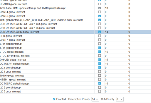

The solution has been the priority of the interrupts. Configuring them as follows:
I would like to know if this saturation is normal or if I am configuring something wrong?

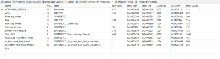

when the timeout occurs, this is the status of the tasks

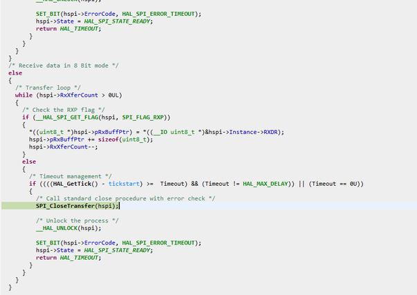

Are you SURE the error you are getting is HAL_TIMEOUT? Your code above just checks for not HAL_OK.
I'm sure it's HAL_TIMEOUT, I set breakpoint when it's different from HAL_OK.

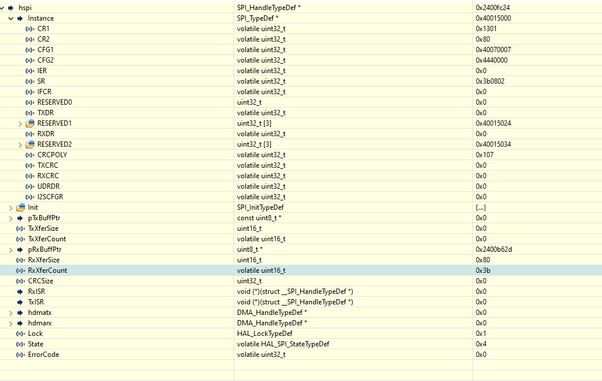

I don't know about the H7 HAL code, but in the F4/F7 HAL_SPI_Receive() there are only 2 lines that can generate a HAL_TIMEOUT error: one for 8-bit data and one for everything else. Set breakpoints on those 2 lines and see what the SPIHandle member variables look like. Has it received ANY data? If so, how much?
It can be seen that it has received some data.
You say "continually skips timeout, even if I put more time on it" - are you saying that even if you change the timeout from 1000 to, say, 10000 (10 seconds), you still get the timeout error (and you have verified it is timeout and not some other error)?
yes, it always skips timeout.
