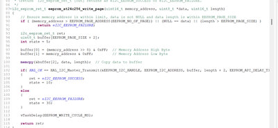

> Though I have been using the Message queue between GUI thread and other UART thread which doesn't cause lot trouble but when only when, Tring to write some data with delay (Changed from 5 millisec to 1 milli sec), still able to see flickering and fluctuations on screen with buttons.
If you do so, especially the delays, from within an interrupt context, you will surely run into exactly such problems.
Mind you, all Cube generated interrupt callbacks run in interrupt context.

Thanks for the suggestion, Yes there was a 5 milli sec delay for write operation which I reduced to 1 milli sec, but still observed the flickering, tried to reduce the clk from 51 mhz to 18.1 mhz the flickering got reduced to better level but not resolved completely.

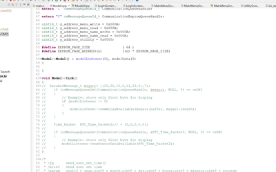

Ohhh boy, start with reply why you save to EEPROM on running system.? Normal is save before power OFF.
Second why do this in model tick. Model tick is executed on screen transitions and disrupt GUI if block.
Then go back to start AND SHOW CODE

The functions are in Model.cpp, not in the Tick function, I guess there is some confusion.

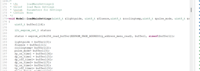

Some of the Data I am saving while device is turned off. but there are some scenario where I need to save some structure having 10-15 parameters to be saved into EEprom at run time, and Load those parameters also, hence need to go this way. Just to avoid confusion here are the screen shots
2025-10-22 6:36 AM

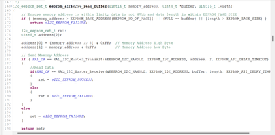

Your showed screens is irelevant, show as code where you call this read and write ...
///code place as code no imageplus show source of eeprom_st24c256 func...
2025-10-22 10:38 PM

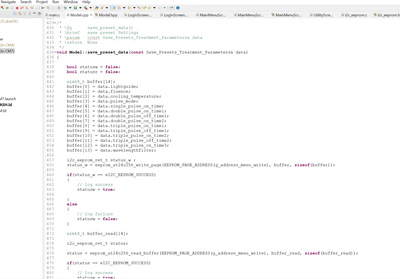

Okay, Here are the functions which are been call for Write Read operations
These operations are called from Model.cpp, eg void Model::loadMainSettings not from void Model::tick() function,

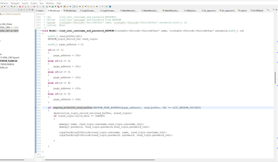

@Shiv09 you still not show where you call loadMainSettings !! And for I2C operation this type is optimal DMA .
2025-10-23 5:13 AM
Okay I am calling from the Screen Presenter, and this is called from Screen View, this is just one of the examples which I am using for read /Write operation.
View-> Presenter-> Model,

I agree with the suggestion to set up a DMA to handle your transfers via I2C.
Or handle them on another RTOS thread and transfer the data using a message queue to transfer data between the model and the thread.
The reason you are seeing less problems after lowering the LTDC clock is that your framerate has now been significantly reduced, and the frame times have become long enough that the writes can finish in time. If you are using a touchGFX Board setup, the frame rate would have been set to 60 Hz. If you are working on custom hardware, look up the appropriate values for pixel clock and porches in the display data sheet. You might then want to verify you are acutally hitting 60 Hz, for example by using the performance measurement functionality provided by TouchGFX: Performance Measurement | TouchGFX Documentation
Have you measured the actual time it takes to transfer data, for example by setting a GPIO when starting the transfer and clearing it when it completes? I suspect it takes more than 5ms.
