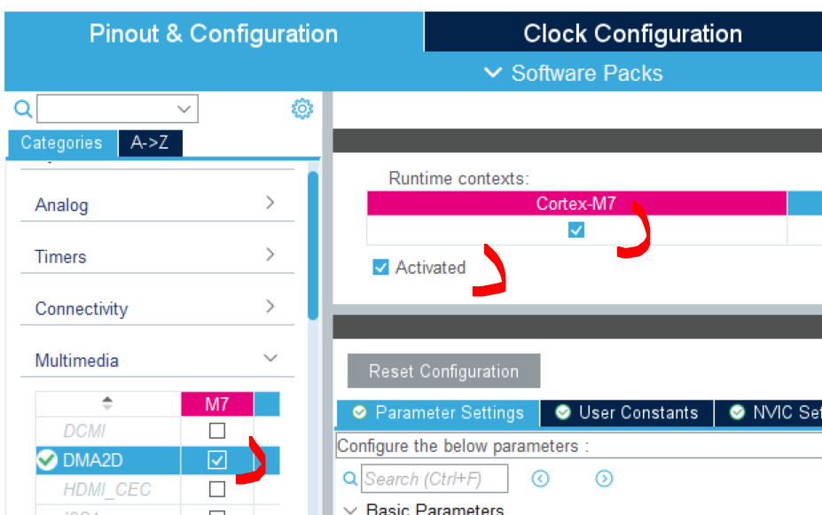

I just checked and it is possible to enable ChromArt on the M7 core. Don't forget to tick the "activate" option.
If you create a project with the STM32H747dk TouchGFX board setup available in TouchGFX Designer you will see that TouchGFX is set on the M7 core.
