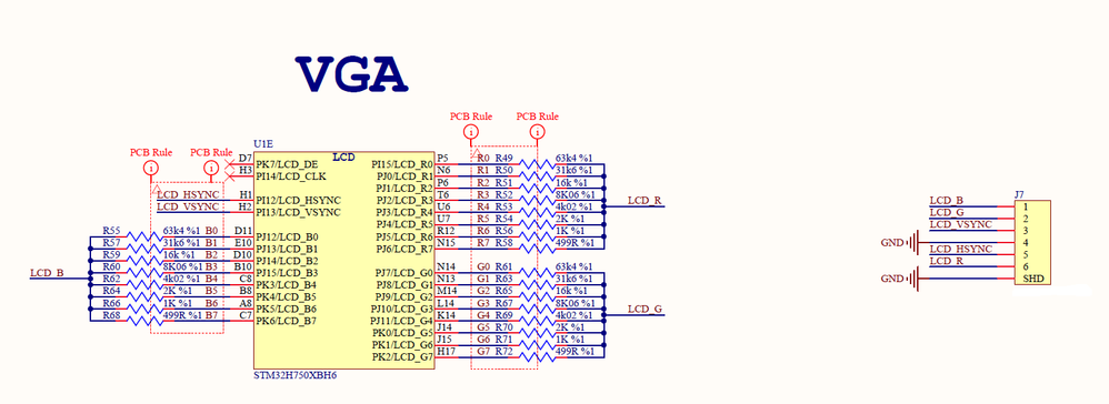

}For the additional information my used VGA circuit scheme is here;
2020-12-06 4:22 AM
I did it step by step like you said and found the problem. My problem root cause is in external crystal. Probably hardware is wrong assembled. I select HSI clock an all problem is solved.
Thank you for helping.
