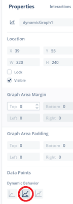

Good, Please note that just clearing the static graph doesnt reset the horizontal plotting. You must also reset X coordinate value and start increasing it again from 0 to 200 (if your X range is 0-200).
If you need constantly scrolling curve, then dynamic graph is right choice. Select scroll as dynamic behavior:
then just simply add points like
	dynamicGraph1.addDataPoint(some_value);
and graph-widget will place it to first free position (and also scrolls the curve if it is full).
So with dynamic graph you dont have to worry about X values. Naturally using dynamicGraph requires that the x interval of the data points is constant, otherwise the graph will be distorted in the direction of the X-axis.
Br JTP
