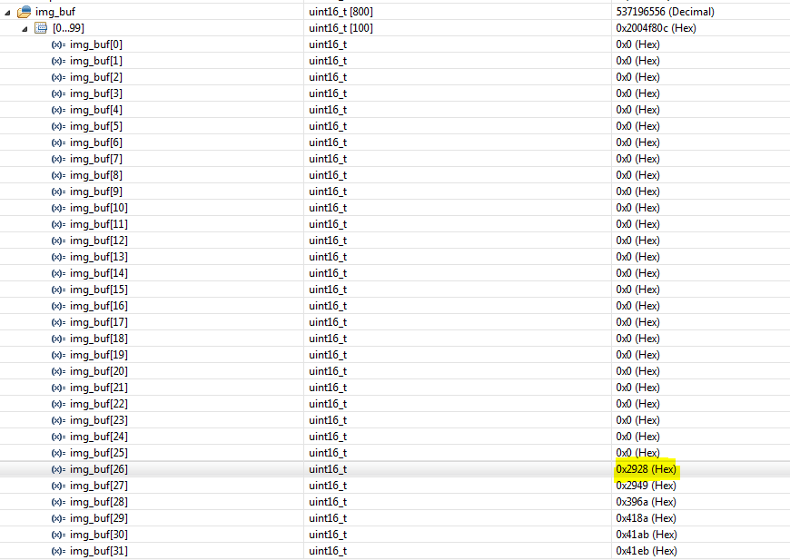

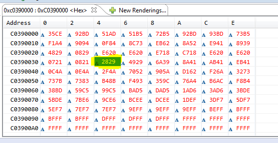

As you can see, I always buffer one line of the image in the SRAM before wrting it to the file. This line is stored in
uint16_t img_buf[800] which is first filled with zeros, so I get black pixels.
After that I want to copy one line to my RAM buffer using DMA2D. This is done 600 times, once for each line.
After each loop iteration I increment my SDRAM base address for the DMA2D by 1600, since each line has 1600 bytes (2 bytes per pixel).
This is where the problems start:
I get incorrect data in my SRAM buffer. I ran a debug session to verify this behaviour.
Here are the contents of the SDRAM and and the line array
img_buf:
As you can see the first few array elements stay zeros while the SDRAM content is clearly not zero. Then I get some correct values starting at the yellow marked elements, but after some time zeros agian and so on.
This behaviour is the same for all lines.
