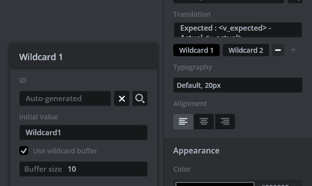

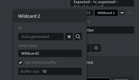

Your text translation looks good, but have you activated the 2 wildcards ?
Also, you need to have the "Use wildcard buffer" check boxes checked to modify the values of your wildcards.
Then, you can do in your code something like that :
Unicode::snprintf(textArea1Buffer1, TEXTAREA1BUFFER1_SIZE, "%d", expectedVersion);
Unicode::snprintf(textArea1Buffer2, TEXTAREA1BUFFER2_SIZE, "%d", currentVersion);We have a very good tutorial that explains how to use multiple wildcards in the same TextArea widget, I recommend you to look at it :)

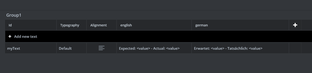

How would I get the translation aspect into this? I'm writing an application in - for the time being - English and German. So, could I get
`Expected: %d - Actual: %d`, and
`Erwartet: %d - Tatsächlich: %d`, respectively, using TouchGFX' built-in translation facilities?

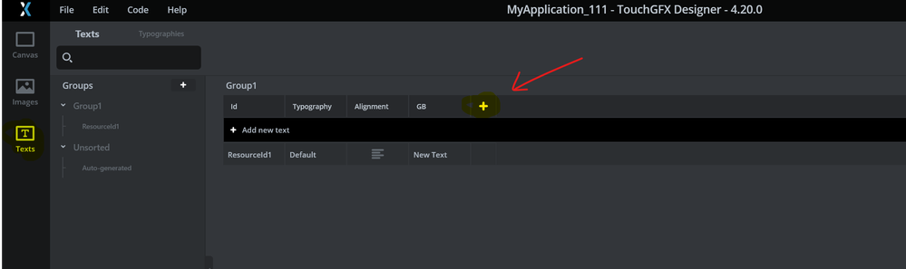

Then, go to Texts on the left panel and cliick on the "+" button add a new language.
You should have something which looks like this :
Notice that all your translation must have the same number of wildcard.

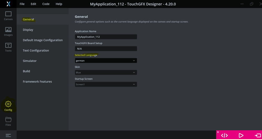

If you want to change language through TouchGFX Designer, go to "Config" > "General" and change the "Selected Language"
if you want to change the language through code, you can use this function :
void touchgfx::Texts::setLanguage(touchgfx::LanguageId id)The parameter touchgfx::LanguageId id correspond to the enum of LANGUAGES that you find in TextKeysAndLanguages.hpp file.
