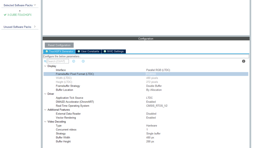

2023-02-21 8:12 AM
Just checking... is this related?
