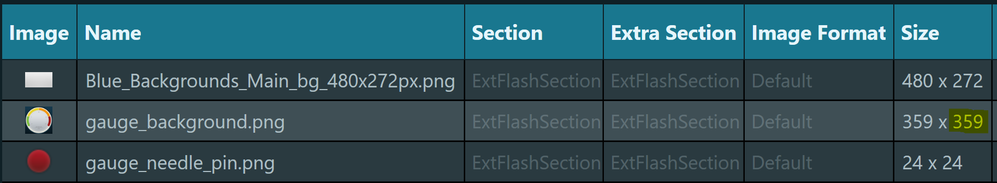

There were a few problems in your project.
First, the assets of the gauge were not the right size. You have a screen 480*272 and you want to fit a picture 359*359. Not possible.
Second, the AT is 24bpp but the painter used for the gauge was a Painter565 which makes the application crashed. Did you try to run the simulator ? Because it was explicitly mentioned. Therefore I changed the painter to Painter888 (look at the variables in Gauge.hpp).
I also made a few changes to your Screen1View files because you were asking the needle to turn every 16 ms by 10 which would have a really strange behavior.
You will find enclosed the corrected project working (tested with gcc and CubeIDE).
Hope this will help you move forward in your project.
/Alexandre
