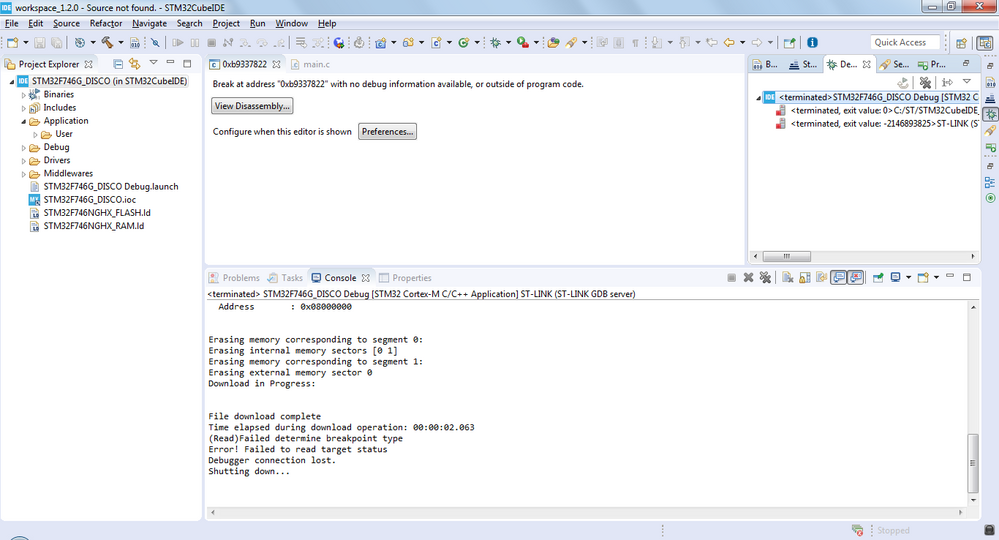

Now followed the exact steps mentioned by you.
Following is the problem:

2020-04-21 2:03 AM
After adding these files when application freezes it executes the following function from syscalls.c file:
void _exit (int status)
_kill(status, -1);
while (1) {} /* Make sure we hang here */
And as you mentioned application hangs at while(1){}
2020-04-21 11:44 PM
Can you show the call stack ?
/Alexandre

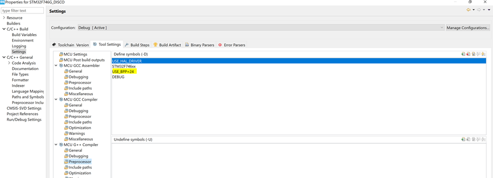

Can you also check if you have the following USE_BPP=24 in your project ? If not please add it
/Alexandre
2020-04-28 8:23 AM
After adding the USE_BPP=24, TouchGFX Demo 1 worked through STMCubeIDE.
But then created new project in the touchGFX with balnk UI Template and added Gauge files as you mentioned previously.
This code hangs at void _exit (int status) function from the syscalls.c file.
Increased heap size to 0x2000 also set canvas buffer size to 7200.
USE_BPP=24 is also added.
