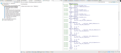

Now it crashes here :
2023-06-30 1:24 AM
The framebuffer is not initialized by C++.
Could you provide a stack trace when you get the fault? and also disassembly of the code.
In some cases it is a wrong configuration of SDRAM. The DMA2D and LTDC performs block access to the frame buffer, but the code may use byte access to the heap.

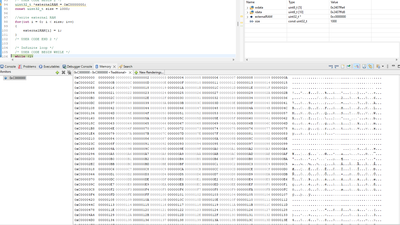

2023-06-30 1:42 AM - edited 2023-06-30 2:18 AM
It looks like my SDRAM is working correctly:
I have a lot of arrays in model.hpp. It would be great to store frontend heap to my external SDRAM cause in RAM_D1 left only 100KB
Now I get MemManage_Handler:

You should start by testing your SDRAM. Write a program that write bytes, shorts, and words to different addresses in the SDRAM. Then read the values to check that it is correct.
It is important that you can write bytes in all addresses, without modifying the nearby bytes.
