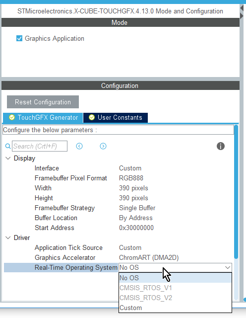

2020-04-30 6:31 AM
Hi @JDant.1,
Simply choose "No OS" when selecting an operating system in TouchGFX Generator, and be sure to not enable FreeRTOS in CubeMX view of course.
And read this for tips on working with TouchGFX and no RTOS: https://support.touchgfx.com/docs/basic-concepts/operating-system
/Martin
