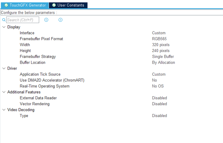

I can see in your X-CUBE-TOUCHGFX configuration, you have set the display to be 320x240, but as we discussed it should be 240x320
Display dimensions
So, please change the Width to 240 and the Height to 320, and check if it helps.
