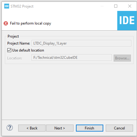

I'm using stm32CubeIDE V1.9.
I wanted create new project example based on "LTDC_Display_1Layer".
Before - I deleted all folder related to this project (because I created it already and did something into but wanted start again from a fresh project) .
I also installed CubeIDE new.
Now I still get this stupid error, see screenshot below.
What can I do? New installation of V1.9 and new start of computer does not work...
Thank you

2023-02-24 5:53 AM
I have deleted the whole folder and content in C:\Users\.....\STM32Cube\... so the IDE had to re-download everything, and now it works....
Of course, downloading the LTDC examples from Git would have been a solution too (I didn't know that these examples are available on Git...)
