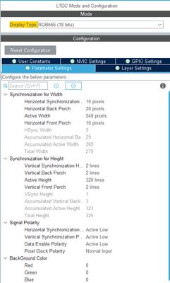

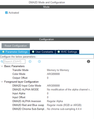

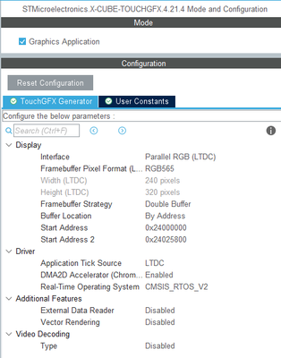

I cannot share with you my whole project (confidential) but I created some sample screen using ST stock images. Below you can find a video and also my configuration you asked about:
The board is custom. We use parallel RGB LTDC RGB666 to drive the LCD. We also use DMA2D. The configuration of the peripherals:
DMA2D:

TouchGFX:

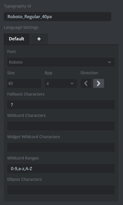

"text settings and typographies":

From the pictures you sent everything looks fine (I assume that in the Pixel Format in your Layer Settings in LTDC is set to RGB565). Since the issue is only with fonts (based on your video), I think it might be helpful to change the location of the Fonts and Text in the memory. So, if it is possible, try to put the fonts in internal flash.
Also, could you please send a screenshot of your Text Configuration from Configs (from TouchGFX Designer)?
