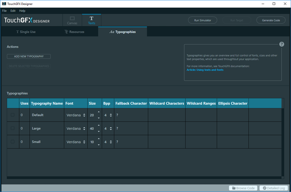

Unfortunately all my text in Text Resources are used directly "0". And unfortunately the font converter has not generated the Glyphs for exotic Characters like "ü" or "ț"
I dont want define each exotic Character in "Typographies" because there are so many characters. Is there any other clever solution? Is there any possibility that TouchGFX takes themselves all text from Resources and convert it although the direct uses is "0"?
2019-07-18 11:49 PM
Hi @MHase,
In the TouchGFX Designer, you can specify a range of characters which the font converter should include(Widcard Ranges), event though they do not appear in any static texts.
These ranges can be specified as hex values. You need to know the value (Unicode) of the first character and the last Unicode of the character range.
/Anders
