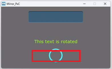

Hello
What if you press here (red square) ?
Did you remeber to flip touch panel coordinates in sampleTouch-function like Martin instructed. This function is typically placed STM32TouchController.cpp- file in \TouchGFX\target\- folder.
Br JTP

Hello
Br JTP

Hello @JTP1
When i click on the circle position the button will be clicked and shown on bottom!
That was my question the coordinates of touch even should be also flipped but i don't found where they should?
