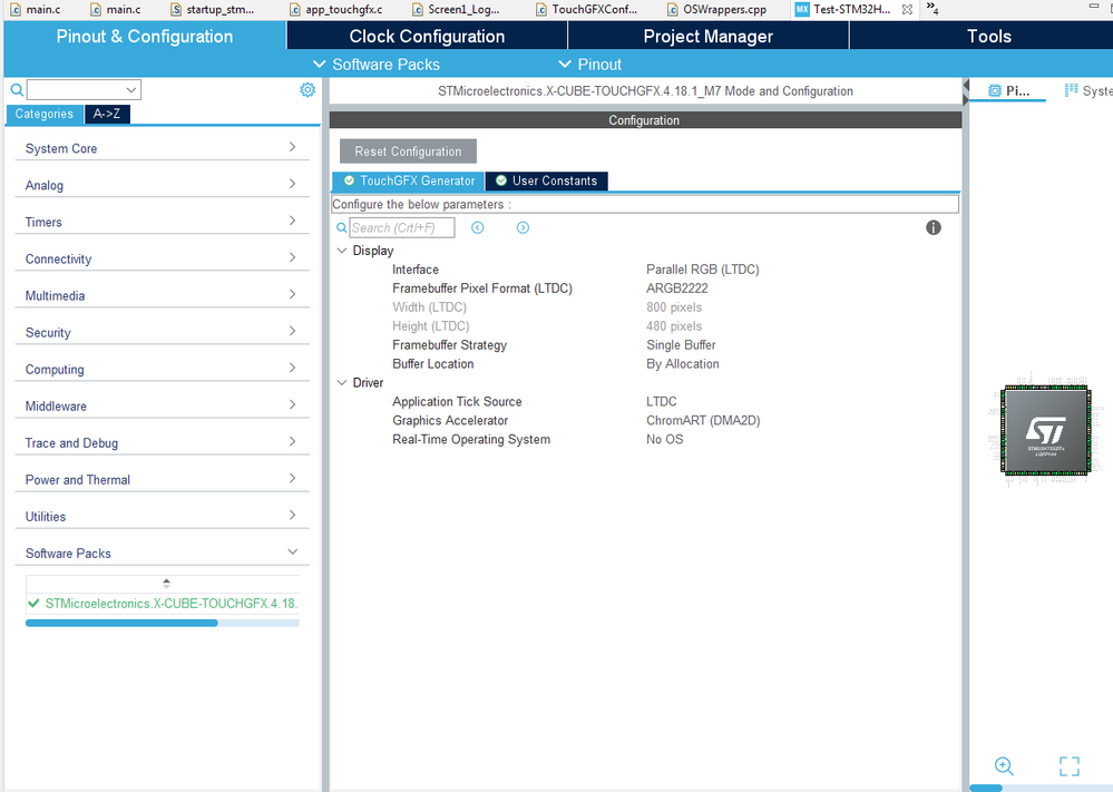

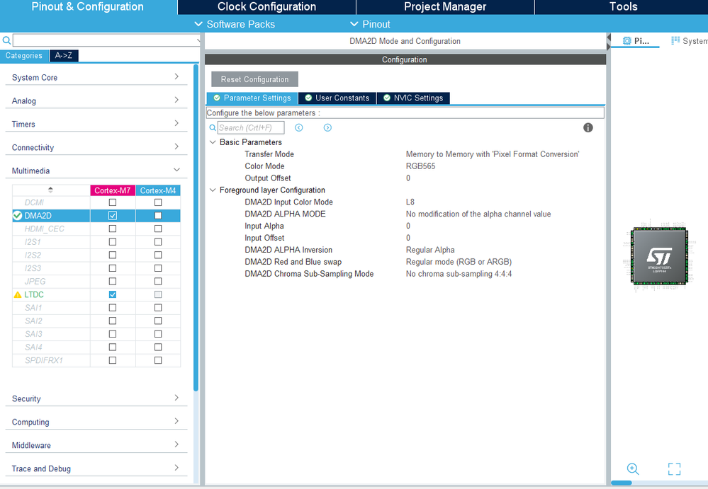

At the moment I'm experimenting with DMA2D Input Color mode L8.
Below you can find all the settings used.
What do you think is the problem?

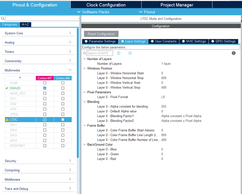

Hello FBena.1,
After looking a bit more closely at your configuration screenshots. I clearly see a problem.
Your color depth format is not consistent.
L8 images are used to save memory but the framebuffer format should not be L8.
Please set everything like you would for RGB565 and you just set the image in the Designer as L8_RGB565 ou L8_ARGB8888 if you want alpha included.
Please refer to the Documentation website
/Alexandre
