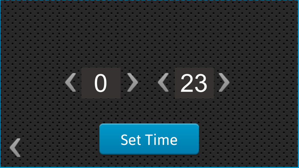

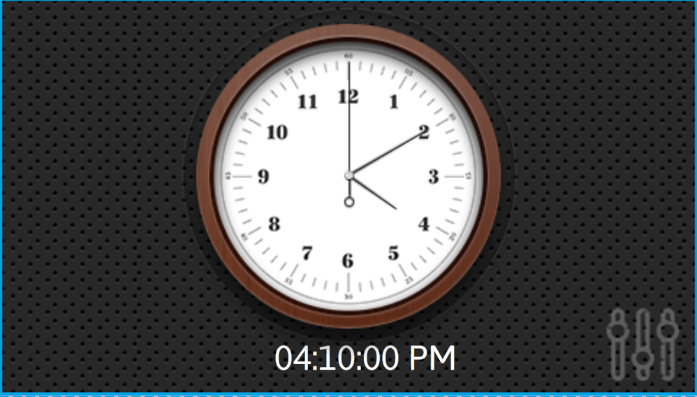

I was modifying an existing UI project that of the clock making the modification to create a second screen to make the modification settings of the clock. I quickly created the necessary keys and two text fields to be able to change the clock time.
Just to facilitate understanding, I attach the images of the first and second screens.

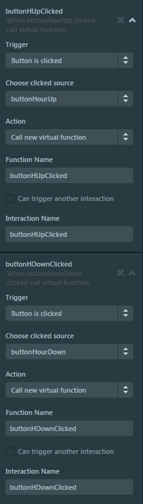

The problem is that I am unable to implement the various functions described in the tutorial that I report: https://support.touchgfx.com/docs/tutorials/tutorial-02, logically changing the names of the variables and anything else.
My problem is that while creating the interactions and setting new virtual function calls, I don't find them in the generated MainViewBase.hpp file as described in the tutorial.

I know it sounds silly but did you click on generated code ?
Because it is indeed very abnormal if you did and you cannot find the virtual functions prototype in the .hpp file.

2020-05-14 2:31 AM
Could you start creating an entire new project ?
Add a button to the GUI and create a interaction that calls a virtual function when you click the button. Generate the corresponding code.
Tell me if this generates the correct virtual function prototype in the Screen1ViewBase.hpp.

2020-05-14 3:10 AM
Thanks Alexandre for the reply,
I did as you said I created a call called ButtonCallPush and now generating the code I find it in the file.
So it works on the new file but not on the old one, I use version 4.13.0 exactly.
The file could be damaged then ???
Roby
2020-05-14 6:08 AM
Ok then try to re-import the UI with clock and add one interaction and a button as well and see if you still have the same problem.
This is something that never happened to me so far.
If the bug persists, can you please write all the steps you did so that we can check if it is reproducible on our side.

2020-05-18 3:22 AM
Hi Alexandre,
I confirm that everything works now I try to do other tests .....
