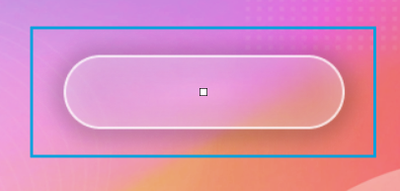

Furthermore, there already are buttons that perfectly fit your description, here is an example:

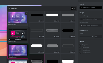

It can be found in the Glass theme :
