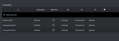

So is it because you use the same text in multiple places, for instance, on every screen you have a "Settings" button so for each screen there is a text for the settings and whenever you want to add an extra language, you have to add it to every text like so :
If that is the case, you could simply set the correct text and translation for the first screen, keep the text area as "new text" for the other occurrences of that same text and set the text at screen startup by using the snprintf() and TypedText() function and referring to text of the first screen : using snprintf() and TypedText()
So I cannot use the same translation row in different screens. Or I would need to programmatically copy a text, but that doesn't show in the preview. I hoped I could just enter the same id in different widgets, but that didn't work.

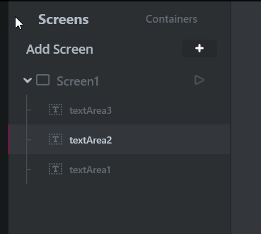

2) Finding lcoation
Do you have a preference on how to find an element in Designer?
Would a search area to filter by element name be good?
This way, only the elements containing the text would show on the left bar.
Example if you typed "textArea" in the search bar:
3) Multiple occurrences
So now, if you type the id of a text that already exist, you get an error, because the ID fileds only lets you choose the name of the ID, but for every single textArea, a new ID is created.
Your issue would be fixed if by entering an ID that already exist, it doesn't create a new text but automatically re-use the already existing text/textID.
